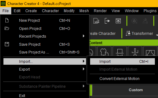

  1. Go to File > Import to import your customized FBX model.

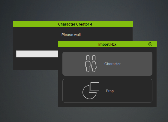

2. Choose “Character”.
2. Choose “Humanroid”.

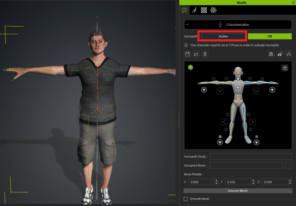

3.After importing the model, click on ‘Characterization’ in the Modify panel. Complete the Bone Mapping, then press ‘Activate.’
For more information on Bone Mapping, please refer to this tutorial: https://manual.reallusion.com/Character-Creator-4/Content/ENU/4.0/09-Import-Humanoid/Auto-Bone-Mapping-Method.htm

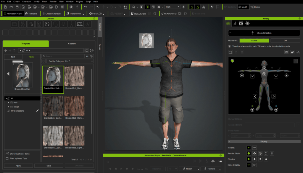

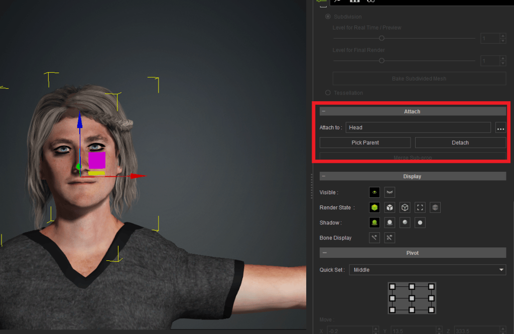

  1. Drag the Smart Hair and use the Attach function to make the hair move along with the head.

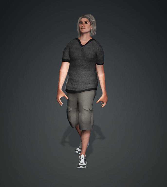

Result.
