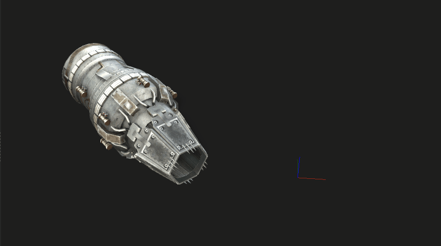

The particle mentioned for instance in the article is: https://marketplace.reallusion.com/d032f-jet-nozzel

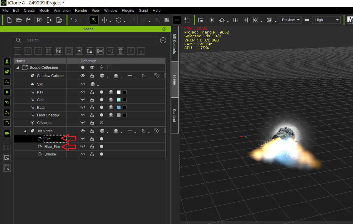

1. Please select the particle that you want to adjust in Scene Manager.

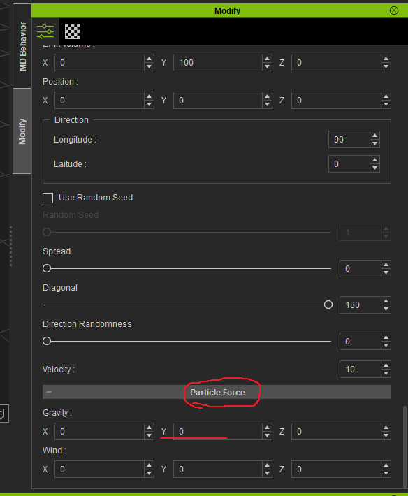

2. The fire particle is originally fixed to emit toward Y=100 in Modify panel – Particles Force section, see below.
    First of all you can send it as 0, so that the fire particle will not be forced to emit to Y=100.

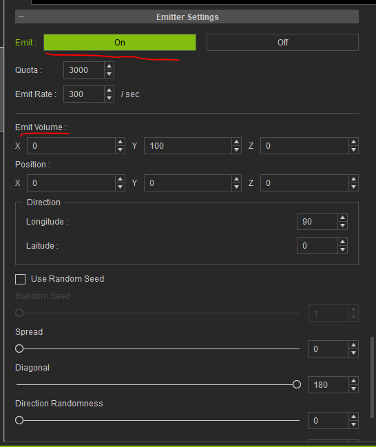

3. Then you can enable [Emit] to generate the particle. [Emit Volume] is for adjusting the effect size.

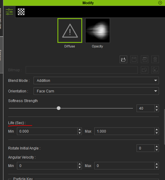

5. [Life] affects the time range for particle residue. You can set it lower if you don’t want the image sticking.
