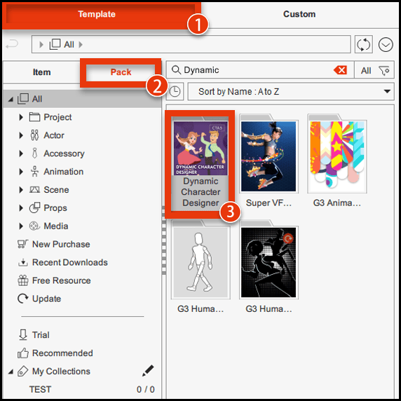

How to find the “Dynamic Character Designer” pack.
  1. In the Smart Content Manager, select Template > Pack > All.
  2. Type “Dynamic Character Designer” in the search bar.

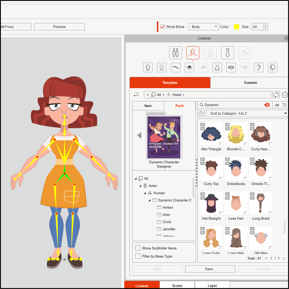

2.Enter Composer mode.
TIPS: How to find the Content Manager in Composer mode?
In Composer mode, find the components in the Smart Content Manager.
How to change out the eyes & hair.
Change out other body parts by double-clicking on the part you like.

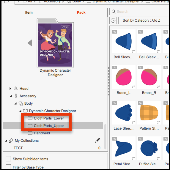

How to add sleeves and skirt.
Choose sleeves in the “Cloth Part-Upper” folder, and skirts or pants in the “Cloth Part-Lower” folder.

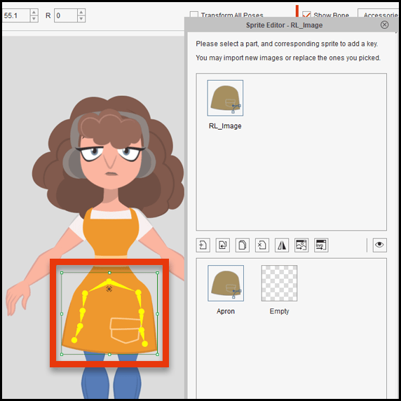

Adjust sprites via the Sprite Editor
[Composer Mode] Adjust the sprites: Press S to open the Sprite Editor and adjust the transform gizmo.

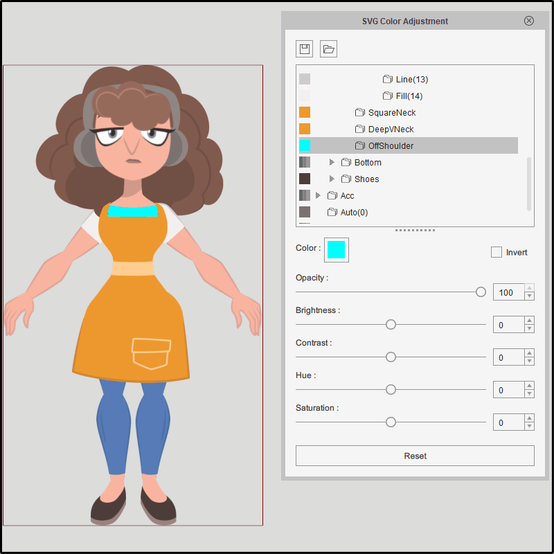

How to modify the shirt color
